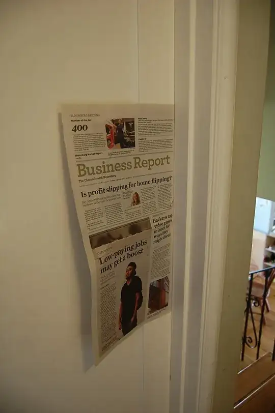

In an older home, due to layers of paint, I have several doors that close too tight to the stop molding. If left closed the paint binds up and "pops" (it must be left closed for two or three hours for the pop to happen).
While I could sand the inside edge of the stop molding, the bottom layer is lead paint, and it's not my first choice to manage the dust. Moving the stop molding also impacts the lead paint layer.
Where can I find a tutorial on adjusting the hinges out a small distance? What else might work on an older house with layers and layers of lead paint on each door and jamb?
door so tight it holds up a newspaper door too tight because of layers of paint

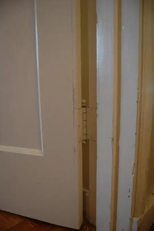

The brown stuff in the photo is paint that apparently stuck during a repainting covered with wax that kinda sorta fixed the problem for a while. See also Why doesn't my freshly painted door fit back in the frame? and the classic Doors are sticky and noisy when opened?

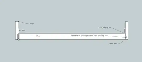

In almost all cases its better to move or adjust the strike plate, the stop, or both rather than move the hinges. Here's a series of diagrams that demonstrate why (dimensions are exaggerated for effect) : enter image description here

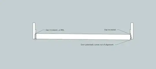

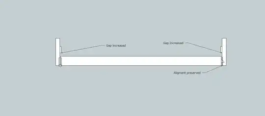

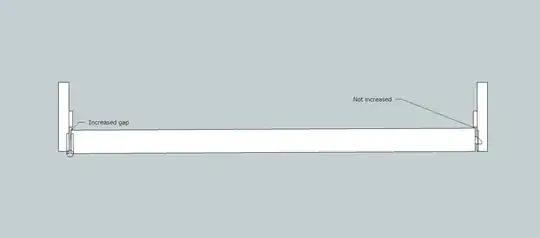

This is an ideal door set up. The gap between the door and the stop is an even 1/32 to 1/16 all the way around. It is not supposed to be tight to the stop. I use a credit card to space my stop off the door when setting a new door. Note that the door is held in its position relative to the stop on the swing side by the opening of the strike plate. In newer strike plates there is a tab inside the opening that can be adjusted without moving the plate itself but older hardware typically does not have this feature. enter image description here This shows how if you only move the hinges as you're suggesting, it will not fix the problem on the swing side if the stop and/or strike are not moved as well. enter image description here This shows moving the strike but not the hinges. It will only open the hinge side reveal a small amount but that may be all you need. The down side is, as you can see, you can only move the strike plate a small amount (which is all it takes in most cases) before it brings the face of the door out alignment. enter image description here This shows moving the stop which solves the problem without having to move either the strike plate or the hinges but it will require you to disturb the paint. I understand your reticence in tackling lead paint mitigation but it's not insurmountable. Here is a thorough homeowners guide to properly handling lead base paint posted by the state of New York's health department. Take the precautions specified, and you should be able to safely relocate the stop and get the results you're after without too much risk. If you do absolutely need to move the hinges, follow the instructions Diceless posted, they're right on. I'll only add that you might want to place a shim the width you're trying to offset the door in the back of the hinge mortise to keep the hinge from settling back into its original position before resetting your doors and to fill the void that will be left behind.

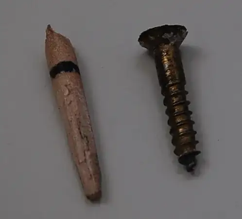

Moving hinges are not an easy task.
Moving the hinges 1/8 of a inch will require repairing the old screw holes first.
To repair the old holes you will need to fill them with suitable filler that will hold the screws. My preference is to wood dowels and wood glue. With a thin layer of glue o the dowel, tap it in the old screw hole. Let cure (look on glue bottle for cure time, usually 24 hours). Once cured, use a chisel to flush the dowel to the door jam. Taper and mark the dowel to minimize chances of splitting the wood:
Dowel tapered to fill old screw hole
Once the old screw holes are filled, you can now remount the hinge. Hold the hinge up to the jam where it will go back, shift it 1/8 of a inch and mark the new hole positions. Pre drill the holes since a screw will not go in cleanly with the repairs.
