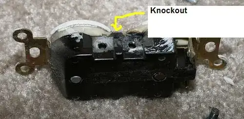

  • SPLIT outlets - These are most common in the kitchen. There should be two blacks to separate terminals, two whites (also to separate terms) and two greens (to same terminal). The difference here is that there is a small knock-out removed between the screws that electrically separates the upper and lower receptacle. This allows you to wire each receptacle to different circuits, allowing you to plug in the toaster and the kettle at the same time without tripping the breaker. When buying receptacles, ask the hardware guy to show you where the knockout is, and when you remove the old one, check for a split. -- Edit based on comment to another answer: Beware of splits because one outlet may be de-activated at the breaker, but the other could still be live. Always check both outlets before opening.
