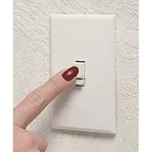

In my opinion one of the critical flaws of most home automation systems is that they break the user interface which we've all grown up with. The person who puts the system in has, implicitly, chosen to break the UI but others have not made this choice: thus the stress.
The best way to avoid this is to not break the user interface. Take lights, for example. The most common UI for lights is a switch on the wall. We're comfortable with that being abstracted to two+ switches in halls and rooms with multiple doors. For automation to be used yet the UI not be broken the automation must use a switch + electronic control. An example of this is a wall switch like this X10 one. alt text
The "wall wart" automation controls which fit between a lamp or appliance and the wall socket almost always break the expectations of users. These guys should be avoided: alt text
An exception is any use where there is not a natural switch, such as Christmas lights, a pump, humidifier, etc.

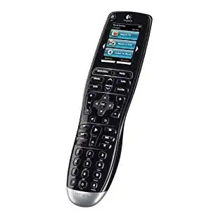

For home theater I've had pretty good luck with universal remotes, but, in my experience, it takes a fairly expensive ($150+) to get a UI that is simple enough yet full featured enough. The Logitech Harmony remotes do a pretty good job at this:
alt text
The bottom line seems to be "make user interface a priority and a key feature" when doing anything DIY, and especially home automation. And something that is a priority is something worth spending time and money on to get it right.
