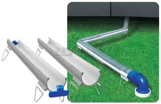

This almost sounds like a common problem with draining RV holding tanks.
You should try to support the drain hose from the tub so you have a gradual slope reaching from the tub/shower drain to the floor.

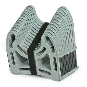

I have a contraption called a "Slunky" which basically allows my RV holding tank drain hose to be very gradually sloped all along its run to a septic or sewer cleanout.
Here's a picture of a "Slunky" like device
Here's an example of a slightly different approach but same concept
