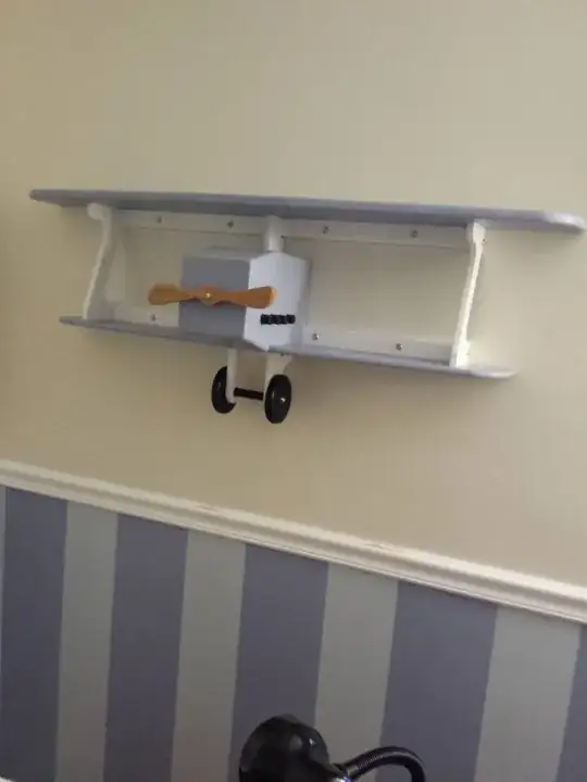

I have had success using it to build small items like shelves, speaker boxes, etc.
Made this shelf for my son earlier this year out of mostly MDF. Wood was used for the cleats.
I personally wouldn't use it for anything that would see a lot of action, vibrations, etc., because of concern over the fasteners working loose. Also, unless sealed really well, MDF really starts falling apart if it gets wet/soaked.
If you are planning on using it, I would suggest using wood glue as a pre-prime sealer (glue size from Wood Magazine: mix three parts of water with seven parts of glue. Apply the size with a foam brush, avoiding contact areas where you need to glue parts together. Let the glue dry overnight. Then sand the glue smooth, working from 150 to 220 grit.). This helps stop the MDF from sucking up all your paint and primer.
Good luck!
