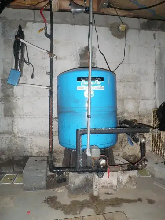

In this case the setup is in the Northeast USA, New York State, with a pressure bladder tank, and shallow well. It looks like the image below. The pipes leading up are the distribution. The pipes into the wall are distribution and pump inlet. The pump does not appear to short cycle.

If the pump does not short cycle, that means the bladder in the tank is OK, assuming you have seldom needed to refill it with air.

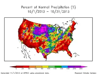

A shallow well could be the root of your problem. Especially if summer coincides with your rainy season. At the beginning of last winter, along with most of the rest of it, the Northeast USA was in a drought:
