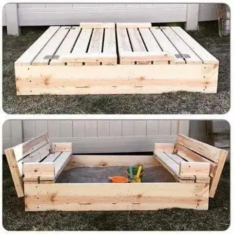

Landscape fabric because even if you was to put wood which would rot. Once sand was put in the weight would keep you from being able to move. Landscape fabric always easy to get and replace. Here is a great design to keep critters out and let the rain drain thru. Jae
great design I am making now
Jae
