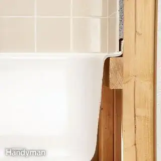

It should (be backer-board) rest on the flange, like this picture:
Picture says it all, click here if you want to read more words.

You can bring sheetrock right down to the flange just like in the picture as long as you aren't going to tile over it.
