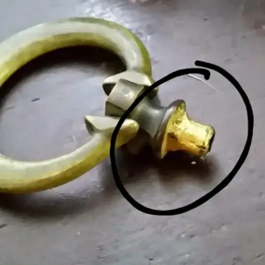

This drawer pull comes from an antique dresser; it mates with a threaded screw that goes inside the drawer.
The collar on the drawer pull has gradually become thinner and cracked, and no longer grabs the screw with sufficient force to pull the drawer out.
How would I repair this drawer pull (there are actually 7 with this problem across 2 dressers)?

You may be able to find some NOS (new old stock) pulls of the same type on eBay or Etsy. I recently did the same thing for an old writing desk that was missing one of the pulls. I couldn't find a match for the missing one, so I replaced the whole set.
If you want them repaired, then they will probably need to be brazed and re-tapped. That is a job that you should have done professionally if you aren't comfortable using a torch.
