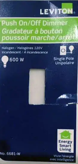

I installed a dimmer switch in my washroom and it's making a buzzing noise. The more I increase resistance/rotate the dimmer clockwise, the louder it gets.
The humming seems to be coming from the common wire, not from the light fixture, live wire or from the mechanism within the dimmer itself.
The dimmer switch is advertised to hold up to 600w and I'm currently using 340w.
I tried to remove some of the lights and the noise persists.
The one thing I did notice is that the common wire isn't exposed or attached at the end, a section of the wire has been stripped at that's what the original switch was attached to.
How can I lessen or completely rid myself of this humming noise?
Edit: I've since replaced my Leviton rotary dimmer with a high end Lutron sliding dimmer and the problem still persists, at the same loud volume.
Leviton rotary dimmer packaging

I suspect, however, that you may be using the "new" CFL (compact-fluorescent) bulbs? They're the ones with the twisted white glass tube. The electronics in most of these bulbs interact poorly with the dimmers and can cause a lot of noise problems, both audible and electrical.

If you read on the package you took a picture of it states incandescent you will get a humming with cfls, or any fluorescent bulbs for that matter due to the igniter that excites the gas inside which produces the light. Incandescent bulbs use filaments which are small pieces of wire that are made to light up when "shorted". Hence the reason for the humming.
