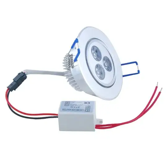

I've just got some LED spots to go in a small cloakroom. What connector should I use to connect them to the mains? The mains wires to the driver are tiny (about 20AWG).
Is there are recommended connector for these, or should I just use Choc-blocks?

I'd use wire nuts to attach those to standard lamp cord, and put a standard plug at the other end...
