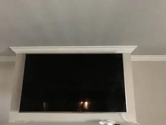

I used two boards, 52 inches in length, used 3 1/2 inch wood bolts, put six bolts with washer in studs and top board was put on wall with bracket at same time. I drilled hole in board first and aligned bracket to hole and stud. I hung a 75 inch tv, worked perfectly.enter image description here we needed three people, with mantle over fireplace.
