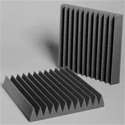

Does covering the walls with a sound-absorbing foam make sense?
My plan is to cover the area around the server, potentially also adding another partition of the sound-proof foam around the machine to further dampen the noise.
Any recommendations? The room is approx 2m by 1m, so quite a small one.

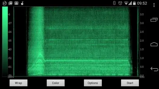

I've taken a sample of the noise using my phone see image: noise spectrum. From what I can see, after the fans initially spin up, they settle down at just below 1kHz. Then, at the bottom is most likely the PSU fan, which spins normally at 4kRPM, half speed of the main fans. Hard to read the scale but I guess the main band is just over 0.1kHz. Although the colour may indicate similar pressure, the PSU fans are much less audible.

Easier than sound-proofing a room would be to build a sound-proof box for the server using the triangular foam. Since it's a rack-mount server, just building some ducts for the front and the back and lining the ducts with the triangular foam you linked to above may be enough.
An even better alternative might be to replace the system fans with low noise counterparts.

A material like this is designed to absorb and scatter sound. With medium frequency fan noise, it usually goes a long way to nearly eliminating the sound. If it were lining a box—even a partial one like a partition—and also covering all walls and other surfaces, it should be satisfactory.
Also, you might inspect the gap under the door. If it is higher than it needs to be, some weather stripping under the door should help considerably.

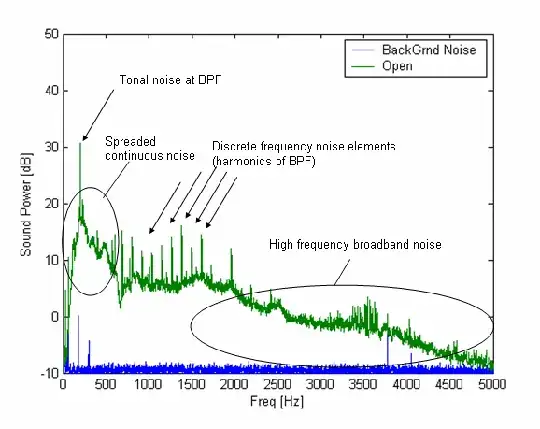

The main source of noise on a server are the cooling fans. The wikibook Noise from Cooling Fans shows the spectrum of a typical 120 mm diameter computer fan:
Spectrum of fan noise
Note that the sound power is in decibels relative to some arbitrary scale and not sound pressure level. While there is a long tail, most of the sound power is at frequencies near (and below) 250 Hz. You are going to need at least 40 dB of attenuation in order to get the server sound down into the noise floor. If the server has multiple fans, you will need more attenuation, but attenuations do not add lineally. You would add 3 dB for every doubling of the number of fans: 1 fan is 40 dB, 2 fans is 43 dB, 4 fans is 46 dB, 8 fans is 49 dB. The real issue is not the amount of attenuation needed, but the low frequency nature of the sound. Attenuating low frequencies is much more difficult than attenuating high frequencies. The cheapest solution is going to be to replace noisy components of the server with less noisy components (e.g., replace fans with water cooling).
If you really want to isolate the server, you are probably going to have to take a mixed approach of stopping the transmission of the sound by placing it in room/enclosure/box with thick walls made out of dense material (e.g., concrete) and absorbing the sound with a soft low density material configured in a way that you get lots of reflections. Auralex has some nice published data on Noise Reduction Coefficient (NCR) of their wedges and the Sound Transmission Class (STC) of their barriers, but I don't think there is anything special about them as a company or their products. They sell a transmission barrier product that provides 19 dB of attenuation at 250 Hz (15 dB at 125 Hz) that would be a good start, but not enough in isolation. Adding foam wedges will get you further along. The ability of a wedge to absorb sound depends on the frequency of the sound and the length of the wedge; the lower the frequency of the sound the longer the wedge you need. Their 4" wedge has an NCR of 0.85 at 250 Hz and 0.31 at 125 Hz. This may sound like a lot, but 20 dB of attenuation requires an NCR of about 0.9. Combining the two products (or any two similar products) should get you pretty close to not being able to tell the server is on.
