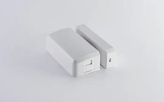

Smart Things offers a temperature sensor.
You could then use their system to have it report the temperature to their ecosystem with alerts if it goes below or above a certain point as well as looking at it any time you would want from anywhere. For extra bonus, you could hook it up to Xively and get graphs out of the system.
