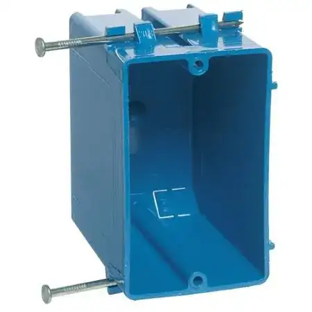

However, this post says that the new wire must be clamped to the switch box, since it is nonmetallic. Unlike the box in that question, my switch box does not have clamps, and looks like this:
How can I secure the wiring to the switch box?
Edit: Just to be clear, the switch boxes are already in the wall and are connected as described above. I am just trying to modify the wiring. I would rather not remove or replace the boxes if possible.

That box does have clamps. The "flaps" that cover the holes are clamps. You push the cable in, and the clamps prevent it from sliding back out.
You can get a dual switch that will fit in a single-gang box. Then you don't need to rewire that bottom box at all. Also, you need to be sure that the top box and fan are wired such that it is possible to separately work the fan and light. A picture of the wires coming into that top box would be useful to confirm the feasibility of this project.
