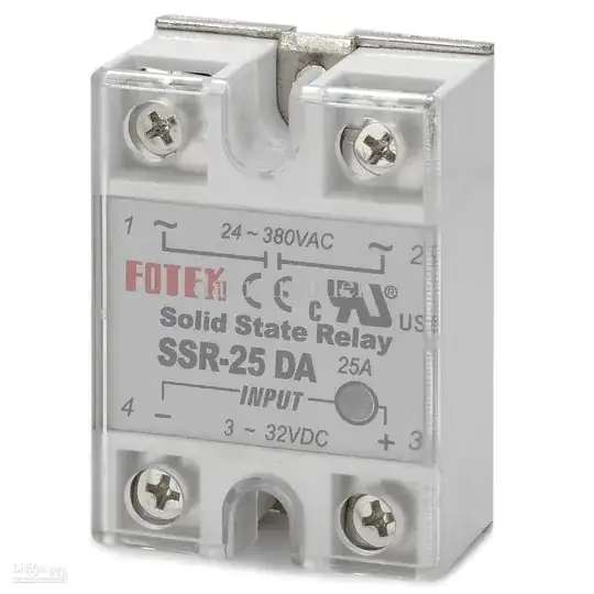

If you are still against a hub, there is one more option you have:
Solid State Relay
Solid state relays. You can wire them inline before all your lights, then put an arduino with it. Example: http://www.instructables.com/id/Arduino-Controlled-Relay-Box/?ALLSTEPS
However you will not have physical switches any more- you will need to replace them all with some sort of momentary switch which ties into the arduino and relays.
