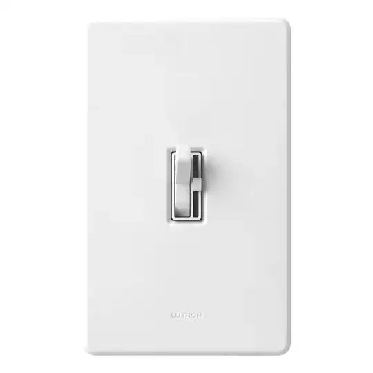

I bought the $20 Lutron Dimmer Switch (TGCL-153PH-WH) from my local big box hardware store. It dims the Cree LED bulbs great. There is just one problem... no matter how I install the wires the switch always tuns off in wrong position. The dimmer is marked UP and the has two terminals on the right side plus a wire at the top for ground.
I had to install it upside down for it to turn the lights on in the UP position. This matters because the slider is on the right side of the switch, sure I can use it upside down (with the slider on the left side but I don't think it's right)
The two wires in the terminal were Black and Orange. I used a fluke tester and determined that the black was hot. This switch actually powers an outlet. From that outlet I've attached 14-2 wire to "steal" electricity off it. What seems to be the problem?
