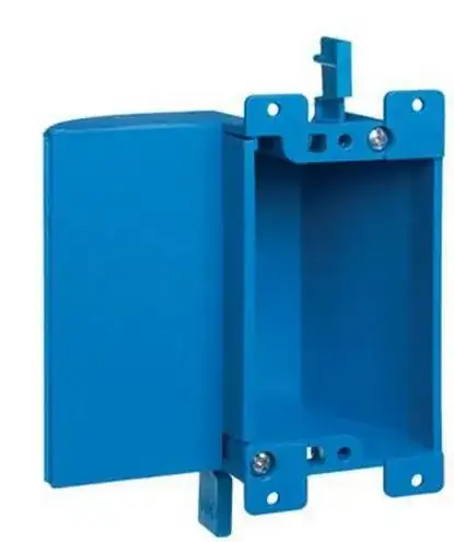

You can also get single-gang boxes with a behind the wall cavity to one side:
Are your walls open so that you could replace the boxes (relatively) easily with double-bang boxes? If you've already put the sheetrock up but haven't taped it yet, you could unscrew it and replace the boxes. If you use double-gang boxes with mud rings, just fill the gaps beside the boxes (where you cut the holes in the sheetrock bigger) with joint compound and tape over them.
