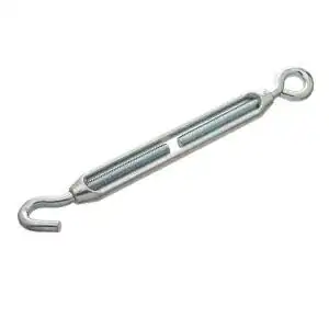

My first thought is a guy wire from the top corner of the post, with a turnbuckle in the middle to tension it up and pull out that lean in the post. It seems that if you don't do something like this, the only alternative IS to reset the posts, which is a lot of work. Hope this helps.
This is what a turnbuckle looks like:
