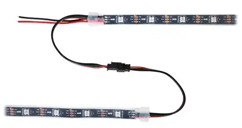

However, the strip lights themselves will not support running that much current through them -- which means you can't just daisy-chain all the strips lights.
From https://www.pololu.com/product/2547:
  • The 60 LED 1 m strip drew 3.0 A and had a voltage drop of 0.6 V.
  • The 120 LED 2 m strip drew 4.7 A and had a voltage drop of 1.4 V.
The voltage drop means you'll have dimmer LEDs.. and at some point they'll stop working entirely. To get around this, you should provide power to each strip. You can interconnect the data lines, but separate power wires should be run to each segment. How long the segments are really depends on how much voltage drop you can tolerate (how dim the LEDs at the end get).
You can use a voltage drop calculator (Google it) to figure out the size of wire you should use for the distance and power draw -- but expect to probably run 18 or 16awg wire from your power supply to the segment.
It may also make sense to use multiple smaller power supplies (with shorter runs), depending on your distances, room layout, etc.

I've done a few projects like this. My guess is that 10 meters is probably too far apart to get results, though it depends on the copper thickness on the strip that you have. I'd hook them all together in a strip and then just add in the +5V and gnd connections every 5 meters; this powers the strips from both ends. You might get away with 10 meters if you do this.
You are going to need some hefty wire to deal with the voltage drop as you are pushing a lot of power through it. A quick calculation says that 5 meters of the strip takes 15 amps of power. You can find some wire resistance calculators online that will help you with this, but my ballpark guess is that you will need 10 gauge wire if you power at both ends.
