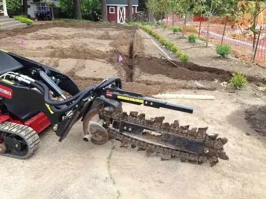

There a variety of trenchers available for rent. Many of the Home Depot stores will rent a smaller Barreto 18" trencher that, depending on local code, can accomplish much of what the homeowner may need done (irrigation systems etc). However, if you want to trench deeper you will need to either rent a larger trencher (Ditch Witch, Toro, Barreto, etc…).
My personal preference is to rent a utility loader and trencher attachment. The depth on the trenching attachment can then be controlled in order to vary the trench depth between 1" and 48" (depending on the length of the attachment).
Trenching attachment connected to a Toro Utility Loader.  Costs a bit more to rent, but the extra power and depth options make it well worth the cost.
