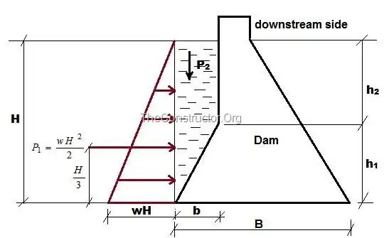

This website has a good explanation of hydrostatic forces on a dam surface. You could build your wall with a submerged lip to help counteract the moment applied by the water pressure on the vertical face of the wall.
Image from TheConstructor.org

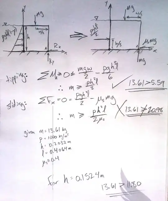

I did some quick calculations and got the following: enter image description here
So to sum up my incoherent scribblings, assuming a 30 lb cinder block holding back 8" of water and a coefficient of friction between the ground and the blocks of 0.4 (which I think is conservatively low), the blocks will not tip, but they will be pushed backwards by the hydrostatic force.
Reducing the water level to 6" results in the wall being able to withstand the hydrostatic force by a small margin. Even so, you'd be risking high water conditions after a heavy rainfall destroying your wall. It will need reinforcement. You could do that by pouring concrete into the voids and increasing the weight of each block to greater than 46 lbs. You could also drive a rebar stake on the inside of each block against the side holding back the water.
NOTE: I did quick calculations and made a lot of assumptions. This answer is an estimate and should not be considered professional advice. (Translation: Please don't get pissed off at me and track me down if your pond floods your yard.)

Unbelievable good math for a block wall, but I think Jim is only going to have one block on the ground at the top of the pond. The liner itself is very strong, and once laid up and over the block, that block is not going anywhere. Not only would 6 inches of water have to move the block, but stretch the liner the same distance as moving the block. The most i would do is drive a few 3 foot rebar rods in the holes of the blocks and fill the holes with dirt or concrete. We have build 100 foot by 150 foot, 8 inch deep deep skating rinks out of standard concrete blocks with absolutely no extra support, just a little backfill behind the block, laid in the liner, the fire dept filled it up and nothing moved.
