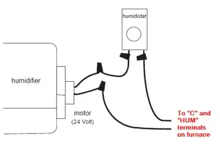

Connecting
In general, by connecting between R and C, the thermostat motor will only have the ability to come on when the furnace is actively heating (it won't come on if the fan is set to 'On' mode, or if the air conditioner is on). Since you have a Humidifier terminal, instead of R you'd connect to that.
wiring diagram
You should also connect the humidistat that comes with it in-line with this wire (doesn't matter wire is which) as per the instructions.

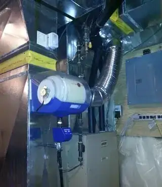

I installed the same humidifier (DS32000) a couple years ago, including the auto-flush valve. It has been working great and I'm very happy with it. It keeps the humidity level very consistent -- though I kind of wish I had an electronic control for it that would adjust based on outside humidity/temperature too (EDIT: I now have this, see below): as it has gotten really cold out in the past few weeks, I've had to turn it down to avoid condensation on the windows.

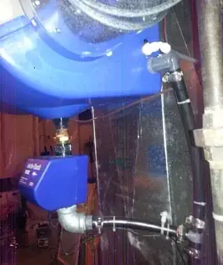

humidifier installed detail of drain lines
Each year I use some vinegar to clean out the valve, basin, and drum (tip: I take the curved plastic lid off, turn it upside down, pour in a mixture of half vinegar, half water, then place the drum in it and rotate it every 10 minutes or so until the whole thing is done). Better to do this at the end of the heating season.
