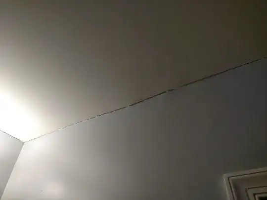

Every winter, we get cracks like this where the walls meet the ceiling in certain rooms. We just got our bathroom redone, so it's most bothersome here. When springtime comes, they "seal" back up. Why does this happen and what's the best way to fix this? Or should I just hire someone? How much would this run minus painting?
Update: thanks everyone for your answers! ultimately, I think the best answer is the "cover it up with crown moulding" since that will look prettiest, add some value, and fixes the issue for the long term. But is that what I did? Of course not!! I went the "caulk it and hope no one notices" route, and, honestly, it looks pretty OK now. I used Lowes White Lightning Latex Caulk and filled in the gaps, then painted. I think there is still a question of how it will look in the spring when it closes up, and if it will "bead" when it compresses. I guess we will see. (FYI there's more info on why this happens in this article I found -- he also endorses the caulk solution: http://www.chicagotribune.com/classified/realestate/sns-201401131900--tms--askbildrctnab-a20140124-20140124-story.html)

The reason why this is happening is the structural members are expanding and contracting with the temperature/humidity changes.
There is no good solution to fix the issues, but you can cover it up.

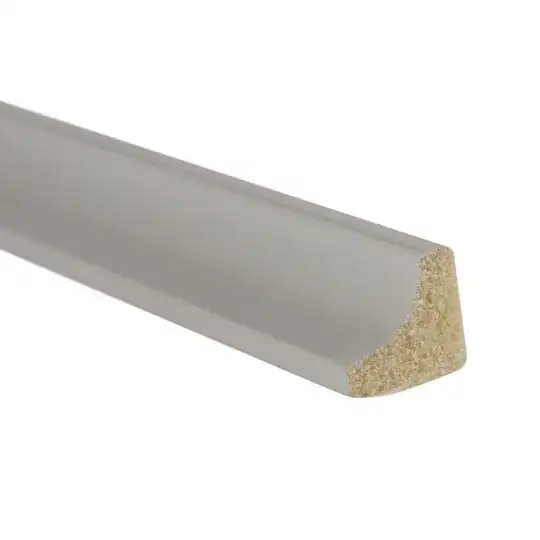

The quick and dirty solution would be to put up quarter round over the seams, and attach it to the studs only- That is not to the ceiling. This would allow for the expansion/contraction to remain covered.
Other options would be to install Cove moulding.
Cove moulding

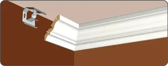

or Crown Moulding
Clip on Crown moulding
Note that the Crown shown here is clip on, and the clip attaches to the wall only. Again, this allows for expansion.

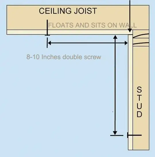

From the picture it seems that the walls were done and the ceiling last and trying to meet the walls. Normally (if done right) the drywall on the ceiling would rest on the drywall from your walls. In this case even if you had a lot of contraction throughout the year you would have a very minor crack at most (which could be fixed with plaster or even caulk).
Picture below illustrates how to do this. Note that the wall would adjust horizontally up to a half inch (width of drywall) and then the only issue would but if the wall contracted up or down which the floating part takes care of.
Since your drywall was not installed correctly you could redo the last two feet and sit your ceiling on your walls. This is relatively free from a materials point of view (minimal drywall, mud, and ceiling paint) but could take a lot of time. Chris offers another option which probably takes more time and has expensive materials. If your house will look significantly better his option is better. If you are really worried about it and want to keep the same look, my option is better.
