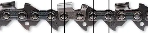

Pitch is the length of the links that make up the chain, basically the distance spanned by three rivets divided by 2 and chain pitch must match the sprocket pitch so the chain is properly driven.
The reason for measuring over the span of three rivets and taking the average to calculate pitch is that the drive link has the rivets closer together than the tooth and span links.
Where the pitch matters, as shown on the simpler spur sprocket chain drive mechanism on an electric pole saw. Chain drive tangs must be the right distance apart to engage the sprocket teeth properly.
