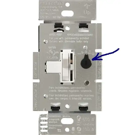

Apparently, here is one switch to get: Lutron TGCL-153PH (TGCL-153PH-WH for white). This has a front-mounted dial to set the minimum dimming output, so you can tweak your LED/CFLs where you want them. The dial is then hidden by the face plate. I actually haven't tried these, but will do that this week. They are available on Amazon, Home Depot and Lowes, and they max out at 150 watts, which is fine for most LED/CFL installations (or 600 watts for incandescent/halogen bulbs). And they are described as "single pole/3-way" as well. They cost +/- $20.00. There are also Lutron decora-style dimmers with similar adjustment dials.
