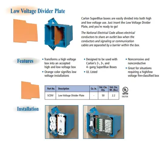

Yes you can, as long as you keep the conductors separated. However, you should likely avoid it if possible. Common practice is to keep power and communications circuits in separate stud bays.
National Electrical Code allows you to put power and communication circuits in the same box, as long as all the conductors are separated by a permanent barrier or listed device.

Exception No. 1: Where all of the conductors of electric light, power, Class 1, non–power-limited fire alarm, and medium-power network-powered broadband communications circuits are separated from all of the conductors of communications circuits by a permanent barrier or listed divider.
Here's an example of a listed device:
From a Carlon sales brochure
Carlon Low Voltage Divider Plate
