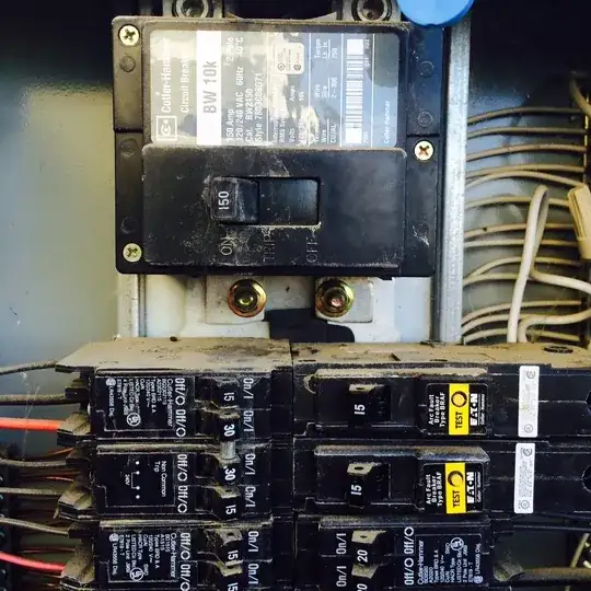

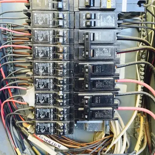

I am looking into installing a sub panel in my basement which will be used to feed electrical circuits to the basement that is currently unfinished. I have an 150 amp main panel and was thinking of installing a 90-100 amp sub panel. I do however have a few questions:
1) Since I do not have any breaker space, I am wondering if there is anyway to replace breakers or shuffle things around to make space? I've included a image below of my panel if it helps anyone make recommendations.

I'll address each of your four questions in turn.
  1. You can do this without moving any circuits by replacing the 20A tandem breaker in slots 10/12 and the 30A two-pole breaker occupying slots 14/16 and 18/20 with a 20A/30A quadruplex breaker with a center common trip which will take the circuit from the 30A breaker and independent, non-tied outer trips that take the circuits served by the 20A tandem breaker -- in your case, the Eaton BQC2302120 -- and then shifting the two 40A two-pole breakers (one is in 22/24 and 26/28, the other is in 30/32 and 34/36) on that side up a full width slot (so that you would have a quadruplex in 10/12 and 14/16, the first 40A two-pole in 18/20 and 22/24, and the second 40A two-pole in 26/28 and 30/32). This would then leave you with slots 34/36 and 38/40 open to put your feeder breaker in, which of course must be an Eaton BR two-pole.

You could conceivably move one of the existing 240 breakers to the subpanel so that you would have space to put in the subpanel.
