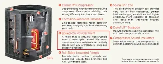

The Trane unit has a special coat of paint that will make it look good for years and years, I doubt you will need to wax it.
enter image descriptionhere
See Page 5 of the Trane informational packet:.
