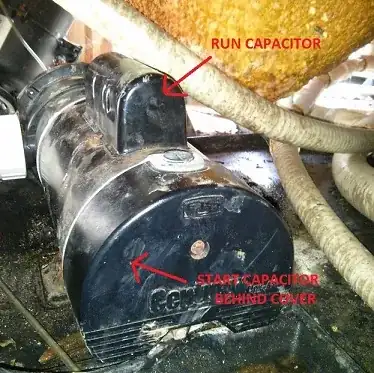

After pulling the motor out (which required draining the spa and disconnecting the PVC connections) and removing the cover, I found another capacitor. Googling the part number indicates that this is a start capacitor. It helps the motor start.
The motor also has a capacitor on the outside, and it's the run capacitor. That's the one that was replaced first.
After replacing the start capacitor, the motor started and is running.
http://en.wikipedia.org/wiki/Motor_capacitor
It turns out that Spa/hot rub AC motors like this have both a start and run capacitor, as do blowers on forced air furnaces and air conditioning units. If an AC motor like this won't start, there's a good chance it's the start capacitor. The start capacitors tend to fail eventually, the run capacitors last much longer, apparently.

I think the answer comes in one of the three things you've already stated: 1) bad pump motor; 2) capacitor; 3) impeller jammed.
In your case I believe the problem is with the motor (as you've probably already figured out).
  • You've already replaced the capacitor. If this were truly the problem, it would have fixed it more than allowing to run for just a moment or two (obviously).
  • If the impeller was jammed with something, changing the capacitor would have had absolutely no effect on it.
  • The description you provided sounds exactly like what an electric motor does when it's going out ... it stalls with a hum.
