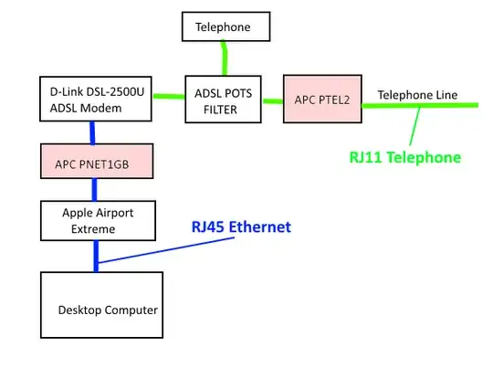

Here is the suggested configuration: enter image description here
Here is the configuration I want to use: enter image description here
As you can see I want to use one protector on the phone line (ADSL internet) and one protector on the ethernet network. All of this will be powered from the 5-way power strip indicated above.
In my research I've read that "chaining" surge protectors is not recommended due to the devices interfering with each other. As you can see below the fault ratings and mode of protection differ between the devices, so I'm not sure if this is an issue?

Does my configuration count as chaining? Will I get better protection using both devices or should I just pick one?
dequadin
As explained in this Electronics.SE article, daisy chaining of AC power protectors, where they both attempt to protect the same electrical circuit, can cause interference and failure. But that's not what you're doing. You have 3 protectors, for electricity, ethernet, and phone/DSL respectively. Those are 3 separate circuits, even if some of them flow into the same devices, so your setup is fine.
