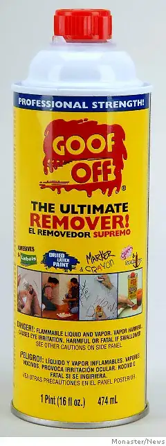

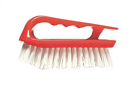

Goof off, tile brush and elbow grease.
(source: nydailynews.com)
(source: labsafety.com)
