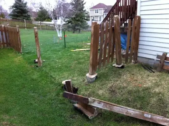

This winter the Minnesota frost heaved up 5 fence posts in my yard.
I've pulled out the 5 posts, and have found basically puddles of water and very very wet mud. I shop-vac'd out the standing water, and have let the holes air out on nice days. When it has rained I've tarped a 8x10ft area to try and get the water down hill. This is what I have been doing for the past week.
Some of the holes are still filled with 3-4inches of water, others are very wet but not filled. The holes right now are around 2ft deep, and I need to dig them to 4.5ft or so.
Should I just dig the holes with standing water? Some of the holes are so wet I'm afraid a deeper hole would just collapse. Or how can I dry them out?
Image of fence

Are you in the Twin Cities? We have lots of clay here. Clay never really dries out ;)
Looking at the concrete, notice how it's flared at the top, this is a nice 'handle' for the frost to grab on to and push up. Ideally, your flare would be the complete opposite...wide at the base of the hole, narrow at the top.
If it's really heavy clay, you may want to forgo concrete completely and instead use compacted crushed rock.
If you stick with concrete, be sure to dig deeper than you need to and put gravel at the bottom of the hole for drainage before putting in the post and concerete. Also be sure to get at least a good 2' of the post into the ground.

I would just dig it out while it is wet. If you really want a clean hole, you could rent a 2 man post hole digger.
That way you can stand far enough away from the hole to keep from caving it in. Personally, I think if you are going that deep, then it does not matter how clean the hole is, just leave some room for grass to grow over the concrete.
The new concrete will still set up with water in the hole.
