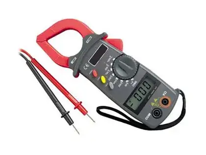

Then you can pull the top off. Inside there are terminals that have black, yellow and red wires that go to the pump. Inside the cover of the control box, it will tell you the resistance ratings (in ohms) between each of the colors, which you can check with any standard multimeter. If those readings are off, then the pump needs to be replaced. If they are OK, the next thing to check is the current draw. You need a multimeter with a current clamp on it, like this:
and you need to be able to clamp around one of the wires while the control box cover is on. The red wire is the starter wire, so it should have a high current then go down. The others should draw whatever the control box says is the normal current draw for the motor. You can measure either the wires going to the pump, or coming from the panel.
If the current draw is very high before it shuts off, the pump is probably jammed. You'll need to pull it and possibly take it apart to fix it.
If there is no or very low draw (and the ohm readings are ok), the control box is probably bad, and you can just replace it without pulling the pump.
