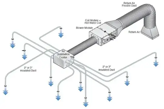

"low-volume, high-velocity" ducted system - First time I have seen something like this. Its very interesting. I did read there are some disadvantages like noise and it can be costly to add.
To Clarify a bit more, I would like to keep the costs low so redoing the entire heating/cooling system is probably not going to be an option. (of course it depends on what costs would be). I intended to keep with the conventional heating/cooling and was more or less looking for a way to still it but avoid soffits. The image below is an example of what I had original wanted but it doesn't seem like that is up to standard?
EDIT-Image below is a not my current hvac. Its also a BAD way to do it. Was using it as a reference. enter image description here

One option would be "low-volume, high-velocity" ducted system (manufacturers include SpacePak and Unico) that uses a series of small 2" diameter ducts to distribute air. Depending on the size of your joists, 2" holes may be acceptable. As @Ecnerwal mentioned, mini-splits can be a good option too.
