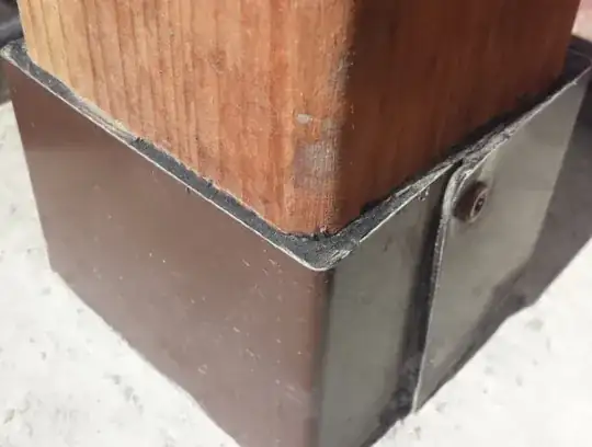

Its the pier size that matters more than the depth.2'in the ground is sufficient, unless there are serious compaction issues. Dig a 12" wide 2'deep hole. Use a post collar to protect the base or crown the concrete. You will only need 135 lbs of concrete and with that still have enough to crown or slope the top. Thats a 90lb pound sack and a half. If you need an accelerator use whats called quick rock. It will cost you about $5.00 per post. The concrete is under $3.00 for a 90lb sack. 3' in the ground is over-kill. I have been hearing this for years and have built miles of fences that I have to warranty.
