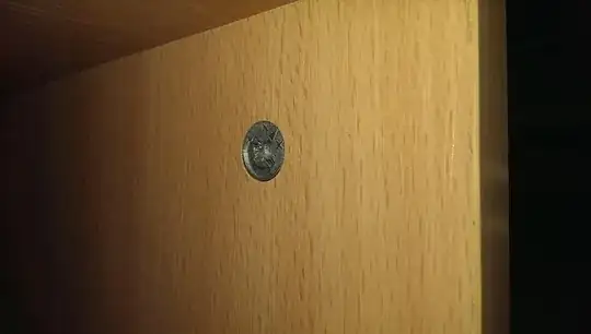

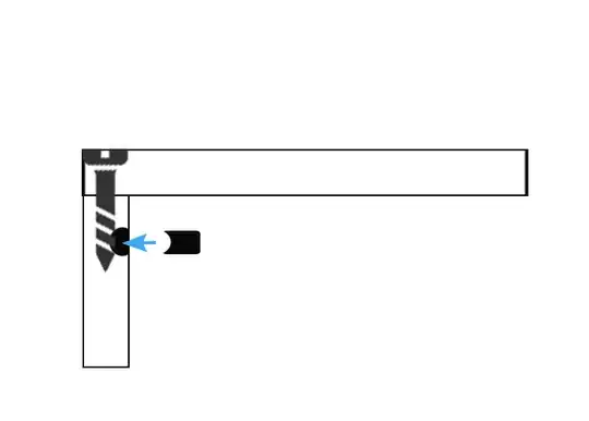

This cylinder-like screw is screwed into an opening on the inside of a table. It basically "locks" into the screw that is facing down from the top.
Screw
Kind of like this:
I'm trying to get them out, yet I can't find advice because I don't know the name of it.

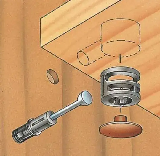

These are usually a cam lock assembly. The insert needs to be turned about a half rotation to release it from the cam bolt.
Here is a picture of what one of these things look like.

This Cam Bolt needs to be turned about 90-180 degrees counter-clockwise.
Watch this video: Click Here
