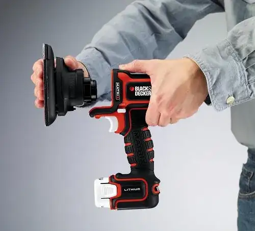

I completely got rid of the texture by scraping it off. I used a Black and Decker matrix sander attachment (that's what I had) with 80 grit sandpaper.
To answer your question about the sander, this is what I used: enter image description here
