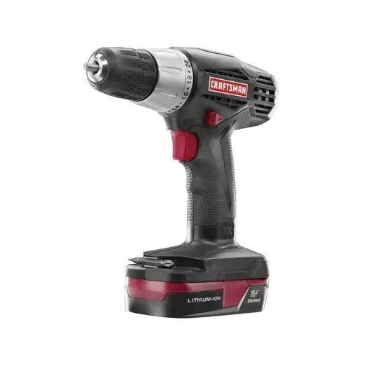

I have a craftsman drill which I use for drilling. When I use a screwdriver head to fix screws in drywall or wood, it keeps on destroying the head of the screw. So much so that the screw head is unusable.
What I am doing wrong? I have the drill on the slowest possible setting of 1.
Edit: This is a battery operated drill. It looks similar to the one in the picture below.

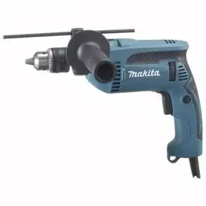

When you say drill. what type of drill do you have?
Electric Drill: enter image description here
Generally a drill used for drilling is geared to fast and does not provide enough low speed torque for screwing things in. Coupled with that, it does not have an instant off or speed break. you can use a special adapter with these drills but its not ideal,
These electric drills (And the more powerful battery type) are also able to drill into walls (masonry). for this the drill incorporates a hammer action (which makes a lot of noise) this is typically referred to as an impact drill) - if you are drilling in this mode. then you will most definitely notice.

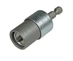

Generally a drywall screw adapter is used to drill in a certain type of screw in a repetitive nature, this is not really a DIY approach, rather for someone who will be drilling the same spec screw into the same material. Drywall Screw Adapter

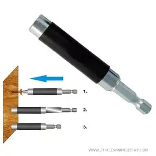

Unless I'm using square-drive deck-screws, which do stay on the tip while driving them, I always use a screw guide. They let you push without fear of slipping off.
enter image description here (threewinindustry.com)
