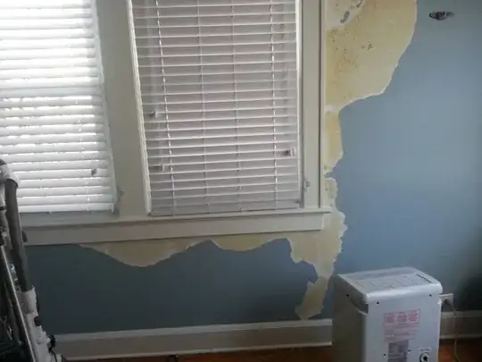

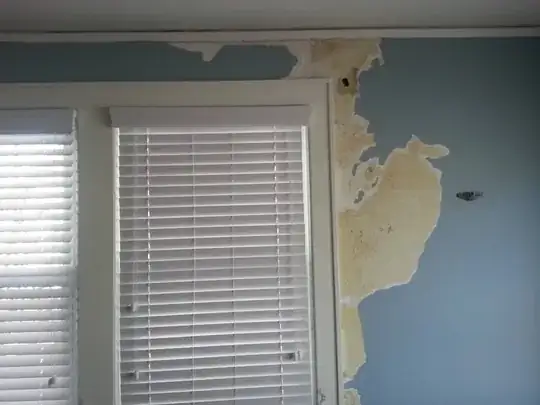

A couple weeks ago ice damming in my gutters caused a lot of damage to my plaster wall inside my house.
I got an estimate of around $2500 to fix the issue so I'm going to attempt it myself. Here is what I plan to do:

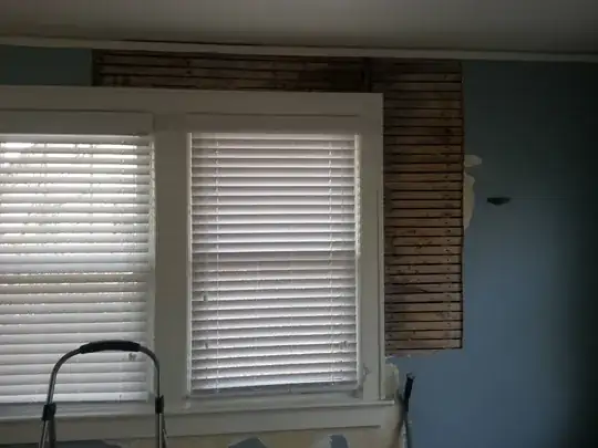

UPDATE (3/17/2015):
Before I started to prep the plaster I cut a hole to double check there was never any insulation (there's none throughout the house) behind the wall and discovered that this situation had clearly occurred before (I just moved into the house four months ago) since there was already sheet rock screwed to the wall and plastered over.
I removed the sheet rock, as it seemed pretty messed up from the water damage. There was no insulation and everything seems pretty dry now. Here is what it now looks like:

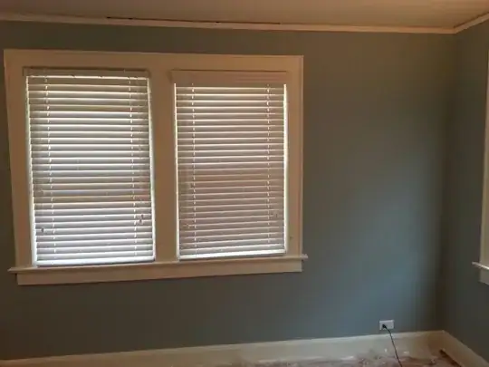

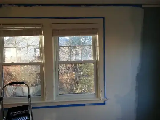

UPDATE (4/05/2015):
Just wanted to give a quick update to show the finished result. This was my first real home improvement project and though it was daunting, and at times it seemed like I bit off more than I could chew, it came out great. Thanks for the help guys!
