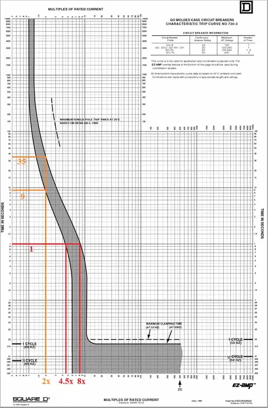

If you look at the trip curve of a breaker, you can see both types of protection in action. You'll notice a slow arcing motion leading down the chart, this is the "long time trip" portion of the chart. As the current increases, the time required for the breaker to trip decreases. Eventually, the breaker hits the instantaneous trip threshold. At this point the breaker trips within a cycle or two. This can be seen at the bottom of the chart, where the curve levels off and goes straight across the bottom of the chart.
Now that we've covered the basics, let's take a look at an example. Here's the trip curve for a 20 ampere Square-D QO circuit breaker.
Click for larger view
The vertical axis is time in seconds, and the horizontal axis is multiples of current. I've highlighted in orange what two times the breakers rating looks like (40 amperes). As you can see, even at 40 amperes this breaker shouldn't trip for about 9 to 35 seconds. This is because it's relying on the thermal protection, and the bi-metal strip has to heat enough before it pulls the circuit open.
I've also highlighted in red what it would take to trip the breaker in one second, since an observer might consider a second "instantaneous". You'll notice that it should take between 4.5 and 8 times the breakers rating, before the breaker trips in under a second. That means your saw would be pulling 90-160 amperes, when the breaker tripped.
If your saw is pulling that much current, the problem is not the breaker, it's the saw. Increasing the size of the breaker is not the solution.
Check the saw for faults, including a short-circuit. You may also want to test/replace the breaker, as breakers can go bad.
