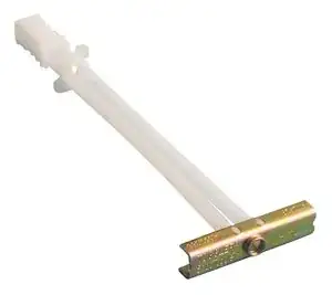

It's not unusual for the wall between tenants to be made with an extra layer of drywall. The Snaptoggle will work in those walls:
It will easily handle the thickness you're dealing with, and it's easier to work with than regular old fashioned toggles.
