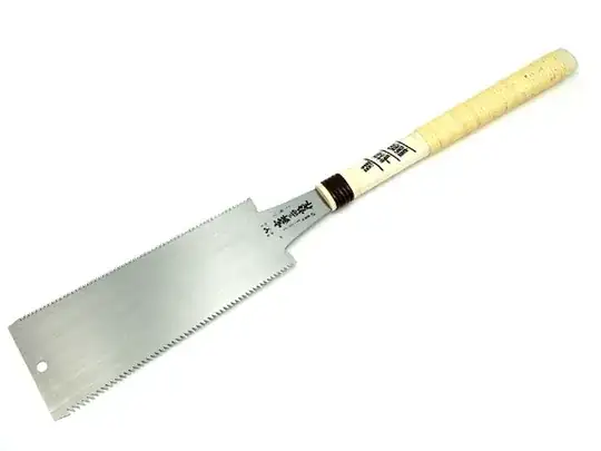

To cut the plywood I am working with a two sided Japanese pull saw. Similar to the following picture.
ryoba saw
For short lengths I can make reasonably accurate straight cuts. The problem occurs when I want to make a 50cm-100cm straight cut. I have a lot of patience so speed is not an issue. Mainly I am asking how people did this sort of work before they had powered tools. Am I using the wrong saw? Should I be using guides? Should the saw just be used to get close and a wood chisel is used to remove the small excess?
