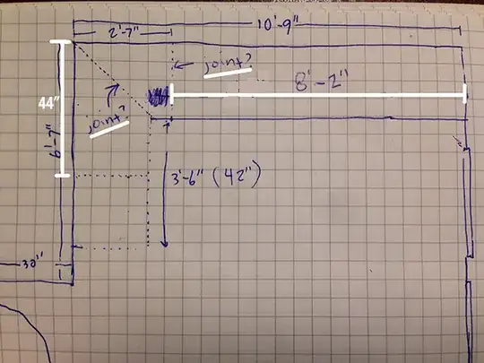

I am installing a wall-to-wall desk in my office, which wraps around on one side.
One side is 10'-9", and the other is 3'-8".
The material is two lengths of oak butcher-block:
  • 8'-2" x 25" x 1-1/8"
  • 6'-2" x 25" x 1-1/8"
I see the need for two joints:
  1. Joining the 8'2" piece with a 2'7" piece to span the 10'9" wall
  2. Joining the two lengths in a diagonal corner
What are the best joints for these? I am installing the counter top using brackets so there will be no legs.
The 45 miter will be your best bet into the corner. Aside from that, please do consider where you want your joints carefully. I would keep them separated as much as possible, yet not in an area where I am going to work at, unless, you are going to sand and finish the top in place and you are certain that you can get the joint relatively flat and smooth. In my opinion, where you have drawn them on your sketch is too much in one place and will draw your eye to that place, not in a good way. Unless you are like me and there will be crap all over the place anyway.... Set the small piece on the other end, that is if it is not going to be a problem there for some other reason.

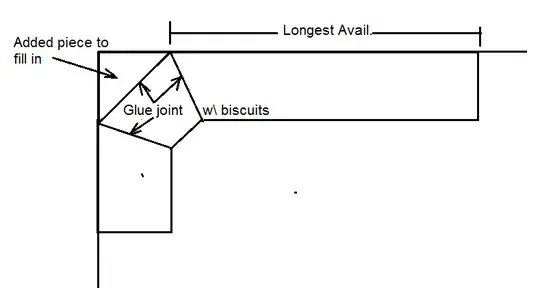

I made a sketch when I first seen your post , I thought this was an idea too, but it may make the corner piece way too big....

For wooden counter tops such as butcher block, a mitre joint will open and close with the seasons unless the room humidity is regulated (unlikely) to a precise level matching the 'humidty' of the butcher block when the mitre is cut. Otherwise, as the seasons change, the length of the counters will stay the same, but the widths (25") will change. Biscuits won't hold and counter top bolts will cause the butcher block to split along the length.
8-3" + 25" is just 6" shy of your room width.
Your best bet is a plain butt joint and creativity with the 6".
