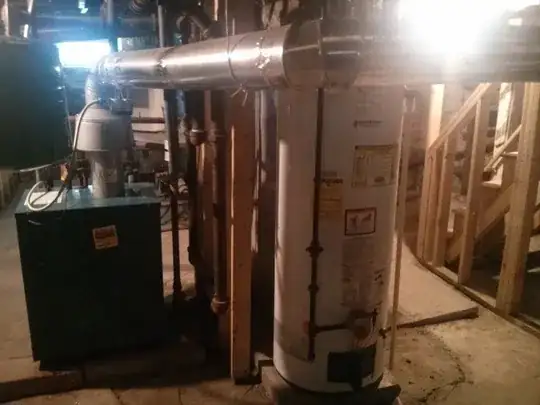

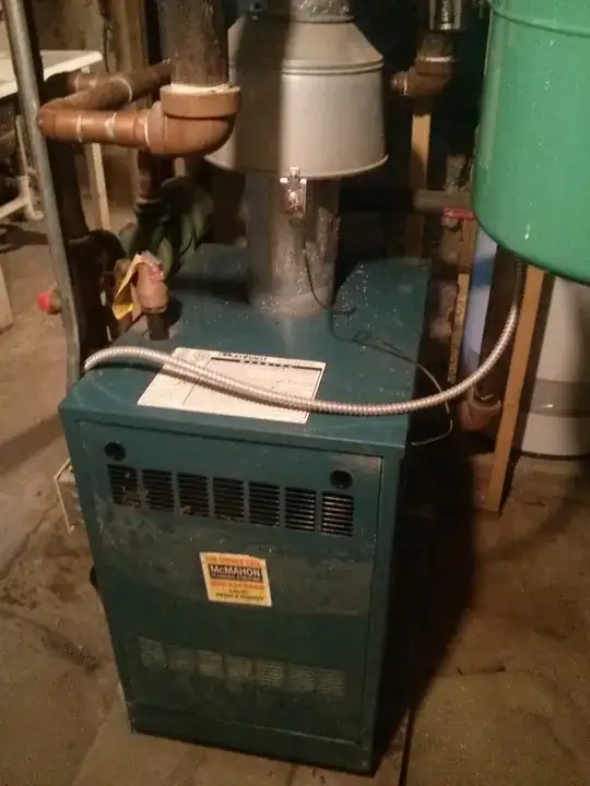

This is the boiler: boiler
This is the start of the exhaust pipe: start of exhaust pipe

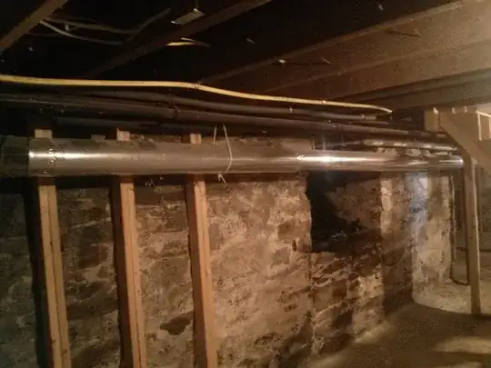

This is the exhaust pipe going across the basement: exhaust pipe across basement

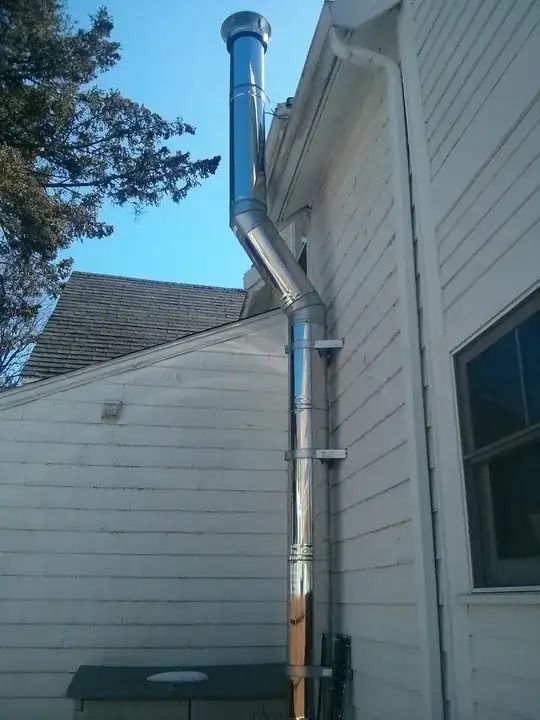

This is the exhaust pipe going up the side of the house: exhaust pipe outside
