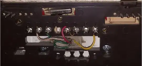

I have an older thermostat controlling an old ass Trane furnace with A/C. It has an "R" terminal and an "Rc" terminal (they are jumpered - see photo). I see references to an "Rh" terminal online. Are "R" and "Rh" terminals the same thing? This video refers to connecting the other external transformer wire to an "Rh" terminal and I am confused.
Old Thermostat Terminals

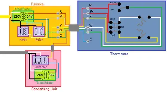

This answer has some diagrams that show how a simple single signal system works. This answer provides another diagram of how a single signal thermostat works, though you can easily imagine how it could be modified to allow multiple signals.
A multiple signal system would look something like this...
Multiple Signal HVAC System
