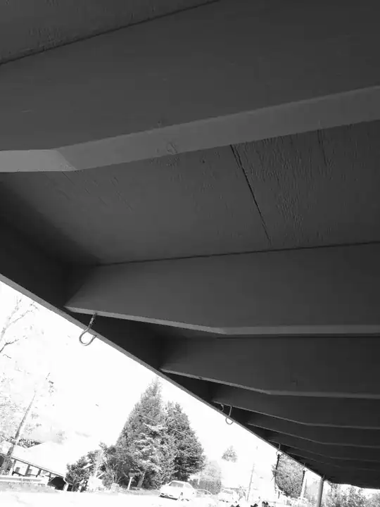

I have a deck where the roof overhang goes out about 5-6 feet. I'd like to hang a porch swing from the roof beams. I'm looking at three person swing (similar to this model). The adults in the house weigh approx 260 lbs, so I would expect a load of no more than 600-700 lbs in total. Image of beams below.
The roof overhang is built on 2x8 beams. I am thinking that I could drill aligned holes the length of the swing (plus a beam on either side), then put a metal pipe of some type through the holes and hang the swing from that. Is this a good idea, or am I at risk of damaging the roof beams? If so, any suggestions as to how to do this?

The problem with the pipe idea is that unless you're going to run it at an angle, you'd never be able to get a pipe through several consecutive rafters.

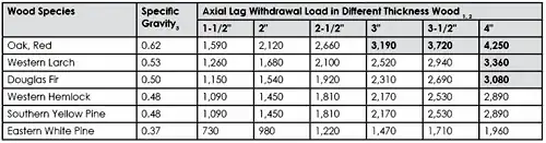

You may actually be OK with lag screws - a properly installed 3/8 lag screw should provide an enormous amount of withdrawal resistance. Here's a sample chart from Masco:1
I wouldn't be horribly concerned about the roof members, as long as you are attaching where they have full thickness and minimize the distance of the cantilever.

1 Not to be taken as a product endorsement or as representative of other similar products. You will always want to check the ratings of the hardware that you actually intend to install.
