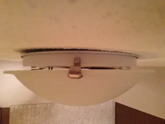

I am having trouble retrieving the light bulb in this fixture:
Angle 1 Angle 2 Angle 3

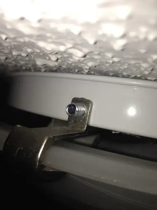

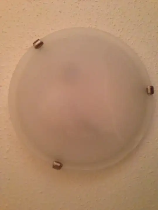

I tried bending the claws to release the dome, but that did not work. I tried twisting the whole fixture many times in either direction, but it did not seem to help to remove the fixture. I tried pulling and wiggling the fixture out of the hole in the ceiling, and it came down a little bit, but it did not come out completely, and I am afraid of breaking something if I pull harder.
What should I do to replace the lightbulb here?

Usually at least one of the "claws" is spring-loaded, and can be pulled straight out to release the glass.
