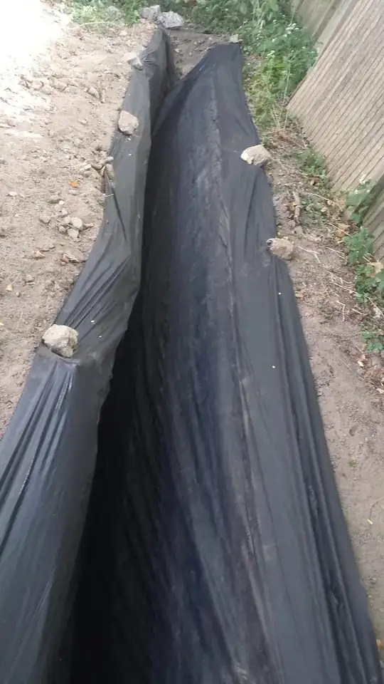

What I did (digging 6ft x 90ft inground trench, and pouring sand to fill it) didn't work. I ended up wasting $15K...My home still shakes, and I'm out of ideas... If it worked, I was going to put up some photos of all the work, but what a bummer (so if you are having a similar issue - don't dig!). I followed the research work by someone in Canada who I liked the idea of, but oh well. Asked the township to resurface the road and stuff. They'll do it over this summer, and I'm hoping that can do the trick. Below is the picture right before sand was poured in.
