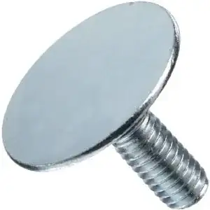

I've used two methods: a silicon like adhesive called "Lexel", and epoxy an elevator bolt to the wall. I prefer these methods to penetrating the stucco, and both methods have been in service for several years.
Elevator bolt epoxy to stucco wall for holding house numbers
With the adhesive you want to account for expansion by leaving gaps between numbers.
With the bolts, hold them in place with tape while the stucco cures. They weigh a lot less than the numbers, and are not hard to keep from sliding.
